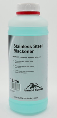

Are you using stainless blackener or normal blackener?
Normal as I've been led to believe stainless blackener is akin to snake oil, the only effective way being to heat the material and drop in oil.
Obviously being rim insulated that's not going to be a viable option.
My MOK 9F wheels were treated with a brown and black covering from some Sharpies. Enough to take the laser shine away.
I tried Sharpies and it basically just rubbed off as well.
Mick,
this seems to be a potential solution (sorry, bad pun) but I’m always a bit skeptical when there’s no obviously available MSDS.
not cheap, either. Then again, a litre would do a few locos, I guess..l
This confirms your suggestion that hot (and acid) is necessary
as does Wikipedia which states
Hot black oxide for stainless steel is a mixture of caustic, oxidizing, and sulfur salts. It blackens 300 and 400 series and the precipitation-hardened 17-4 PH stainless steel alloys.
however, it goes on to note
Room-temperature blackening for stainless steel occurs by auto-catalytic reaction of copper-selenide depositing on the stainless-steel surface. It offers less abrasion resistance and the same corrosion protection as the hot blackening process.
it would appear that there are cold blacks for stainless available. How toxic they might be is a consideration.
best
Fitzroy
There are definitely cold blacks that work- It helps if you first activate the surface by wiping with hydrocloric acid on a cotton bud or similar.
This one is in Australia but the same US company supplying that one in Simon's link above.
Cheers
Piet
