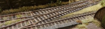

With Sheep Dip's trip to Uckfield now just under two weeks away, layout preparation is underway. This unfortunately has included the removal and replacement of one of the points due to a pesky short.
The replacement point had to be painted and weathered before being laid. Tricky as the weathering needed matching to the existing trackwork.
Before......
After........
Replacement point.
Step one- Spray with Humbrol Dark Earth.
Step two- Paint sleepers ( Humbrol 173 )
Step three- Add Dark Rust weathering powder to rails, chairs, etc.
Step four- Weather sleepers with various weathering powders.
The rest can be blended in situ once ballasted but this is the current state of play, prior to weathering.

I've finally laid the point and added the ballast. The usual PVA mix was employed to bind it all together, except it didn't. Glued on Friday but as of late Sunday afternoon, it still wasn't dry.
Mysteriously, Sheep Dip made it's way from the garage only to be 'discovered' by the Memsahib in it's revised drying location on the dining table, yesterday morning.
The ballast had dried off and is now solid. Last night, a bit of blending in took place whilst I shouted at the telly as Wales failed to deliver against Belgium.
With due apologies for a very bad image, here's the current state of play.
Fishplates to paint, weeds and grasses to add, track pins to camouflage.
Rob
