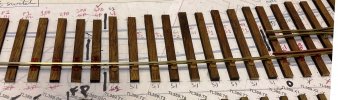

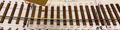

Hello all,
started work on the first stock rail for one of the points on the front of the layout last night, so here's some photos to show the slow progress.
First the check rails and chairs, the check rails are from Off the Rails and are about 10 thou below the running rail height. The first and last chairs have the correct lead in and out to them. To me these look better than cutting and shutting S1 chairs to do this job.
First on the running rail from the check rail chairs are 9 S1 chairs from Exactoscale, then onto the special point chairs the "names" of which you can see at the top of the point in red.
The second part of the point showing how we're going to move the blades via the two large (5mm) holes.
I've still go to fit the droppers to the stock rail, for these I'm thinking of three of them on these point stock rails, one near to the track joint off the photo to the left, one between the last/first S1 chair and one near to the BBJ. The switch rail will have at least one dropper near to the S1 chair. I may fit one near to the common crossing along with another on the stock rail.

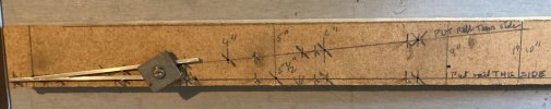

Talking about points I have been making these for the fiddle yard gang seven point common crossing (point vees), 1:8 X 2 and 1:10 X5. The 1:8 not a problem as I have a jig for this angle but the 1:10s no jig so I used the 1:8 jig for the basic cuts and filing angles and well?
I made a jig in the best bodging it style and this is what I came up with. Its not pretty or elegant but it worked for what I wanted.
The first common crossing (can I just call them vees from now on?) The long 1:10. This vee is about 9" long to stop us having to use short bits of rail on the lead up to the point.
