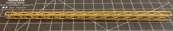

as Kev was persuade (OK press ganged) in to making the signals, he's the only one of us to have made a working co-acting semaphore signal and that was in 4mm.
So I thought it would be nice for me to fold the lattice work up for him. I've got some hold and folds to help make the job a bit easier.
WELL the instructions say not to take the tabs off so I was tempted to have a look at what the 20' post would look like.
Me like!
ATB
OzzyO.
PS, the lattice work is 20', 10' & 7'.

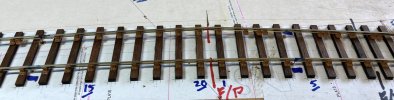

back onto my last four lengths of rail to fix in place, what can possibly go wrong?
Getting ready to fix the chairs down on the L/H rail I'll do it my normal way get one chair stuck down every five sleepers working from both ends. The problem with this bit of track is that it has to fit between two lengths of track that are fixed down.
The same bit of track photo'd from my drone, the blue dashes that you can see remind me which chairs are fixed down. Sometimes it's one on each side of the track sometimes it's two on one side. Means the same thing to me. The next photos are about where there is a big step in the Templot plan.
Then it was what the **** is going on here, so it was a quick call to Euston saying we have a problem (see what I did there).
It looks a lot worse in this photo but not that big a problem to sort out, all I had to do was chop off about 1mm of rail clean up and refit. I think that I got it first time! (make them door frames a bit wider so I can get my head out). After that it was just sticking down chairs and a quick check around, before I drop one of these two boards and start on the cosmetic fishplates and bits in the points.
