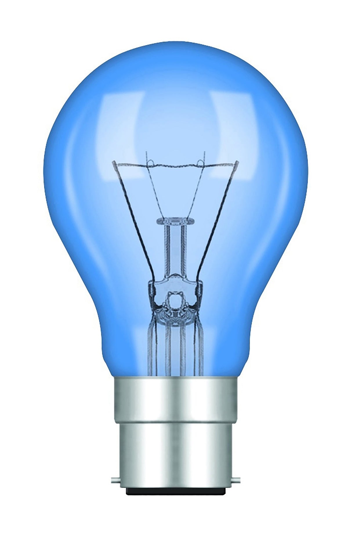

Very true - however the discussion mentioned "daylight" incandescents which have a blue-tinted glass to filter down the excess red (And make them a bit dim in the process!) and I assume they are the only things anyone would even consider in this context as they produce a much more uniform spectrum. Even these days they are still available and they are still probably the best artificial source.
Unfortunately, at 40W you needs a fair few!
