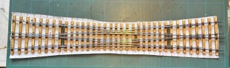

Goods yard expansion. Shunting the kick back sidings requires the coal siding to be cleared each time. So I dusted off my Templot skills and plotted out a double slip to replace the single turnout and allow the addition of a headshunt. Originally I was going to use toe to toe points, but it didn't look right at all...
Out with the milling machine to make some point blades...
I was trying to work out from your picture how you set the rail up at the correct angle for milling. I have a small Proxxon milling machine, but I still file point blades by hand because I can't think of a reliable way to set it all up. :confused:
Richard
dibateg
Hi Richard -
I jack up the end of the brass bar with an 'L' shaped piece of brass wire - I think it is 1.3mm. You can see the long leg projecting from the table. You can vary the length of the bar and thickness of the wire to change the angle of the plane.
