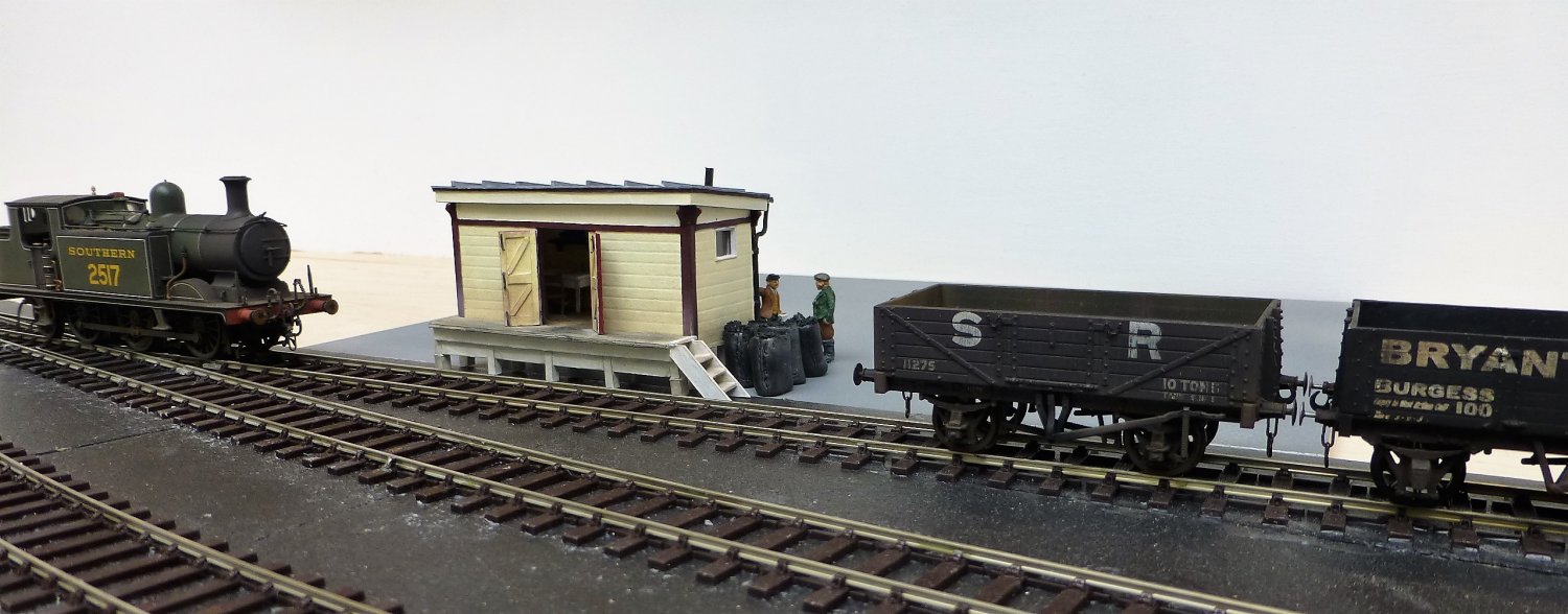

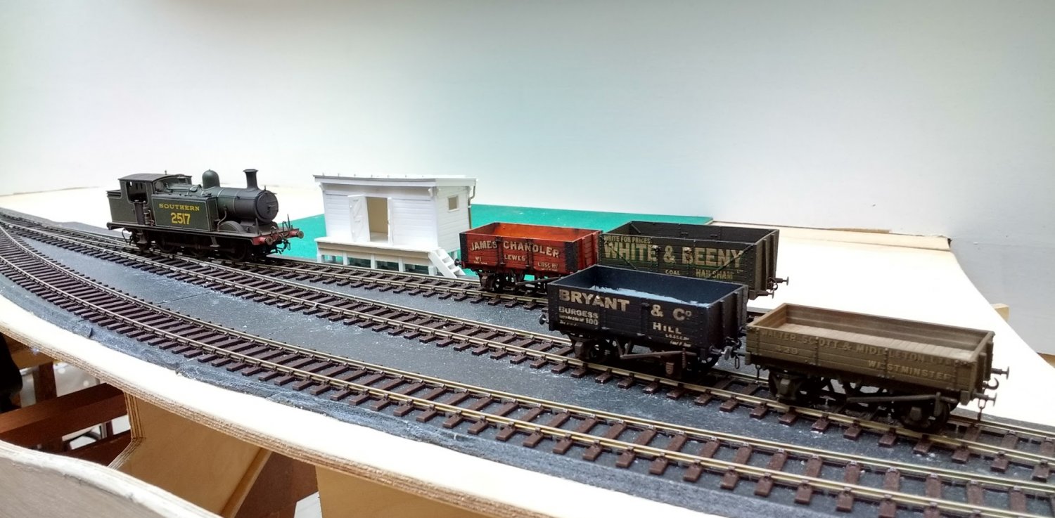

Aah, now the wretched electrics are done, I can really play! I've been working on the coal office. The pictures show it in situ, but without any scenery.
Fantasy time - it's 1932, but the old LBSCR lock-up has been maintained in Brighton colours.

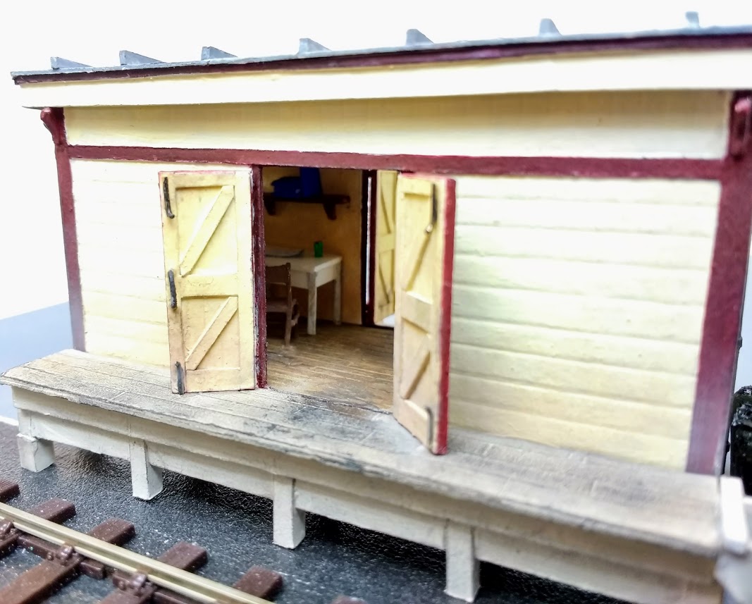

Open doors reveal a table, chair, shelf with old ledgers, and on the other side a cupboard and a coal burner. More stuff will be added as time goes on:

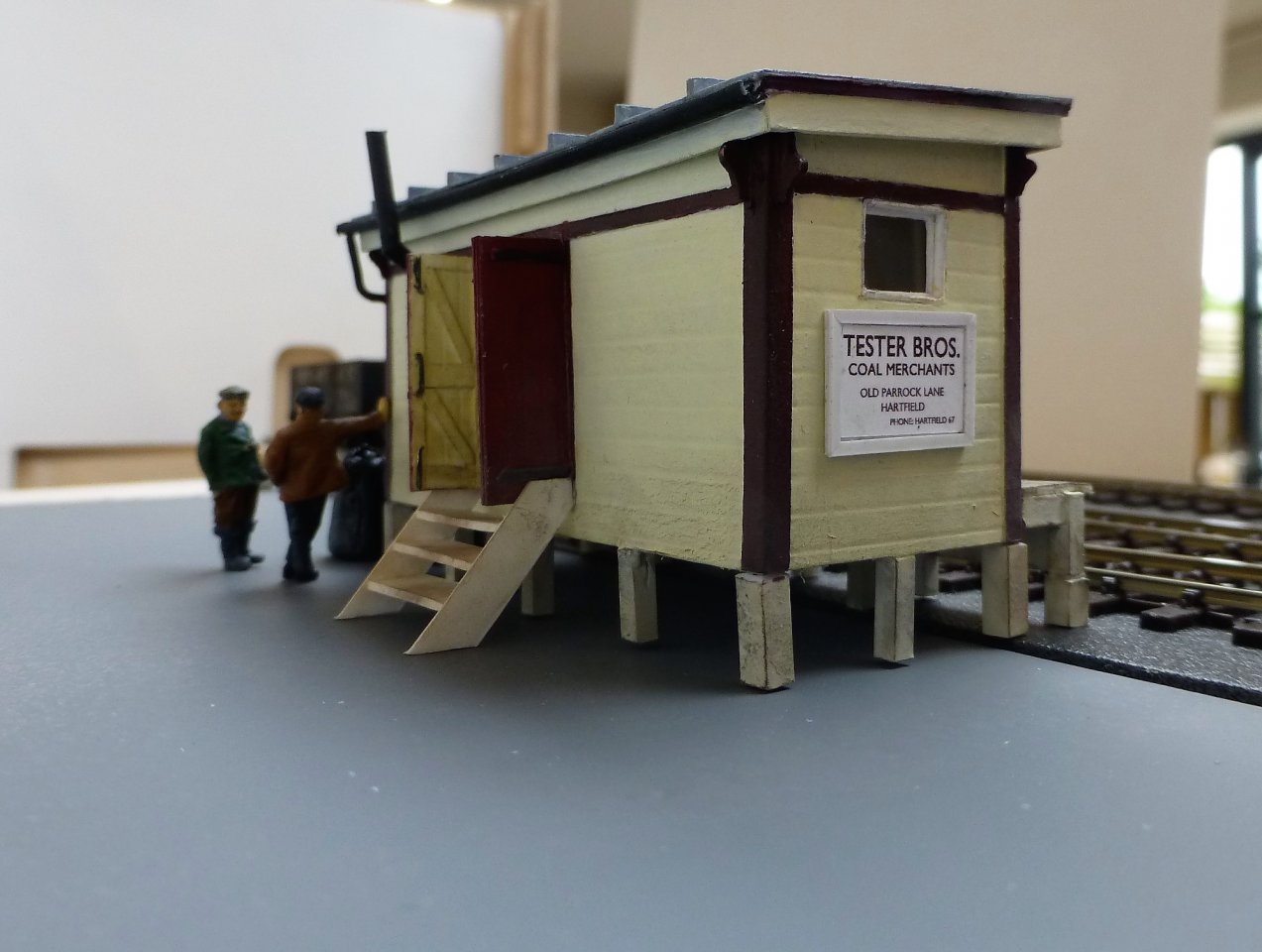

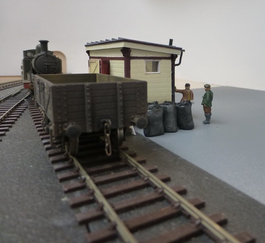

It's time for a mid-morning cuppa, and George Tester, the coal merchant, is having his regular cogitation with Sid Haffenden who works at the farm. It's the usual theme - the fortunes of Brighton and Hove Albion in Third Division South last season. Arthur Attwood was an excellent buy from Bristol Rovers, he scored 35 goals and helped the Albion to 8th place. It's pretty much the same conversation each day.
The hundredweight coal sacks are for the ever hungry hot water system at Bolebroke Manor. They are being collected later in the day.
You may notice that the sign says 'Tester Brothers'. The business was set up by George and Frank in 1921, when they bought the lock up. Unfortunately the two brothers fell out over a shared passion for Betty Stapley and Frank ran off to New South Wales. The argument was actually pointless because she didn't want either of them - she married the local butcher.

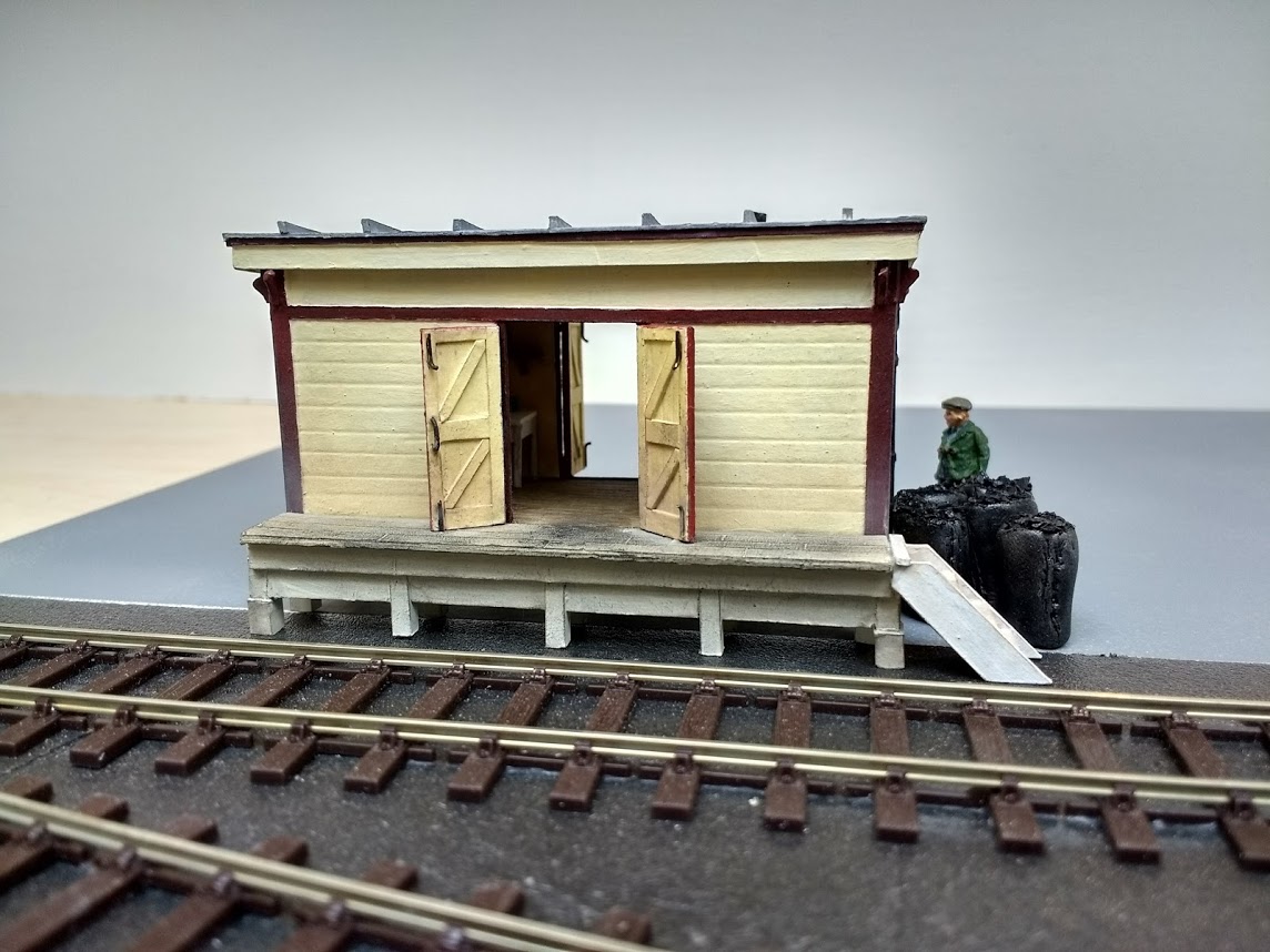

The coal office was made with mounting card. It worked reasonably well, but it didn't take paint as easily as I'd like. I'm going to use art card for the outer skin of the cottage and mill.

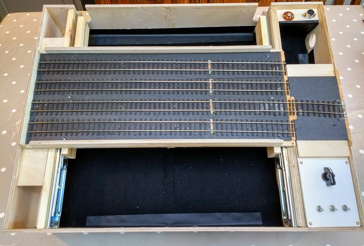

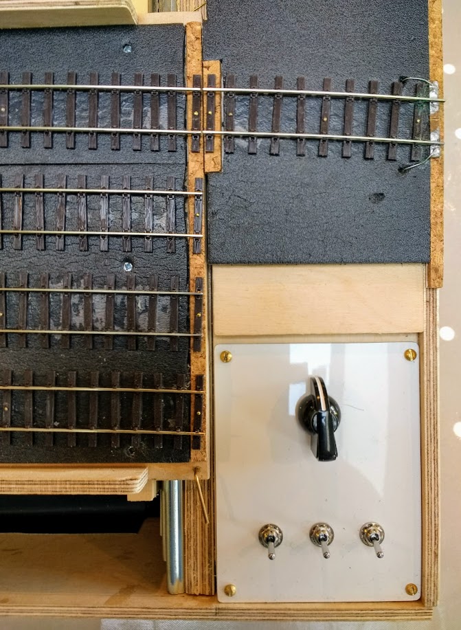

One of the downsides of being a lone modeller is that you have to learn by doing rather than being told what to do. That is also the advantage of course. Why am I writing this - well, because of necessity I've been developing the left fiddle yard. I have made a traverser with drawer runners and it works really fine, but I've also discovered that foam underlay is absolutely no good for an accurate alignment of tracks across boards or gaps. That's obvious, you may think - well it is now! Although it's OK for now, next time I won't use foam in the fiddle yard and I may change it if time permits.
Here is the fiddle yard. It needs cleaning up, but that will happen in time. Track alignment is achieved by rod in tube, and it works surprisingly well. The felt sheets from Hobbycraft have two functions; they protect any wires underneath, but also provide a soft landing for valuable stock should the inevitable happen. A bit unconventional perhaps, but it works for me.
The three switches work the three points on the layout - left to right, and the rotary switch is for the traverser with an extra position for 'all roads off'. It's all working smoothly. A further development will be a short vertical panel to extend the sky beyond the layout to ease the visual transition.

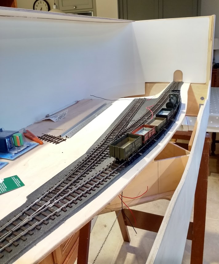

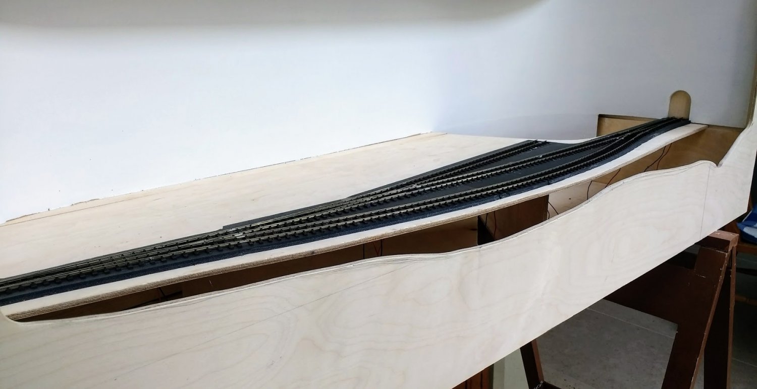

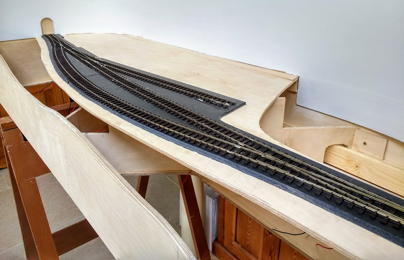

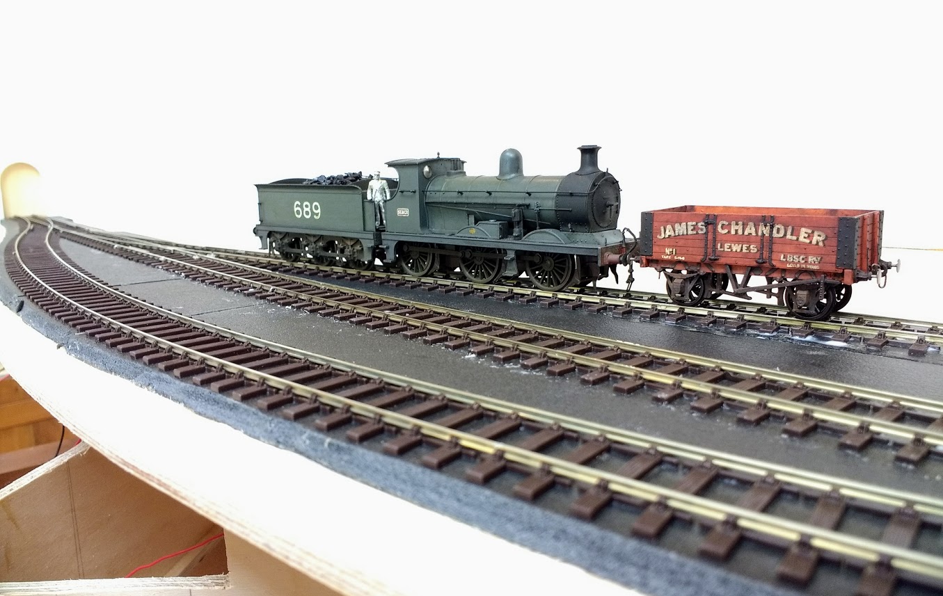

Track is now laid. I hope to start the electrics next week - and get it out of the way as soon as possible because it's my least favourite job. Mind you, it will be stupidly simple; one engine in steam so all live with the only isolating switches in the fiddle yard.
The hole in the sky needs opening up a little.
At the moment the whole thing is stored in the corner of the living room with tools and stuff distributed around cupboards downstairs. There may be a decent shed in the offing, properly lined etc. It's exciting in one sense, but I'm wondering whether I will really want to spend my time out there - I'd hate to invest it and then find that it's not really my preferred way of doing the hobby. Personal criteria would be a reasonable sound system and a kettle for tea/coffee on tap!
Any comments or advice on this would be welcome.
What a super sequence of photos - the shape of your layout is already apparent, and the loco is very convincing.
The vertical bolt to locate the traverser is a very elegant idea - I may nick that idea,

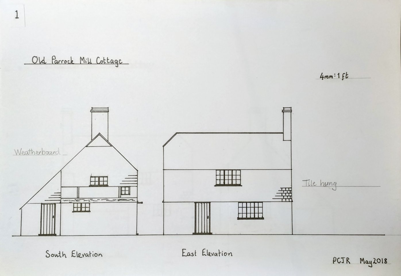

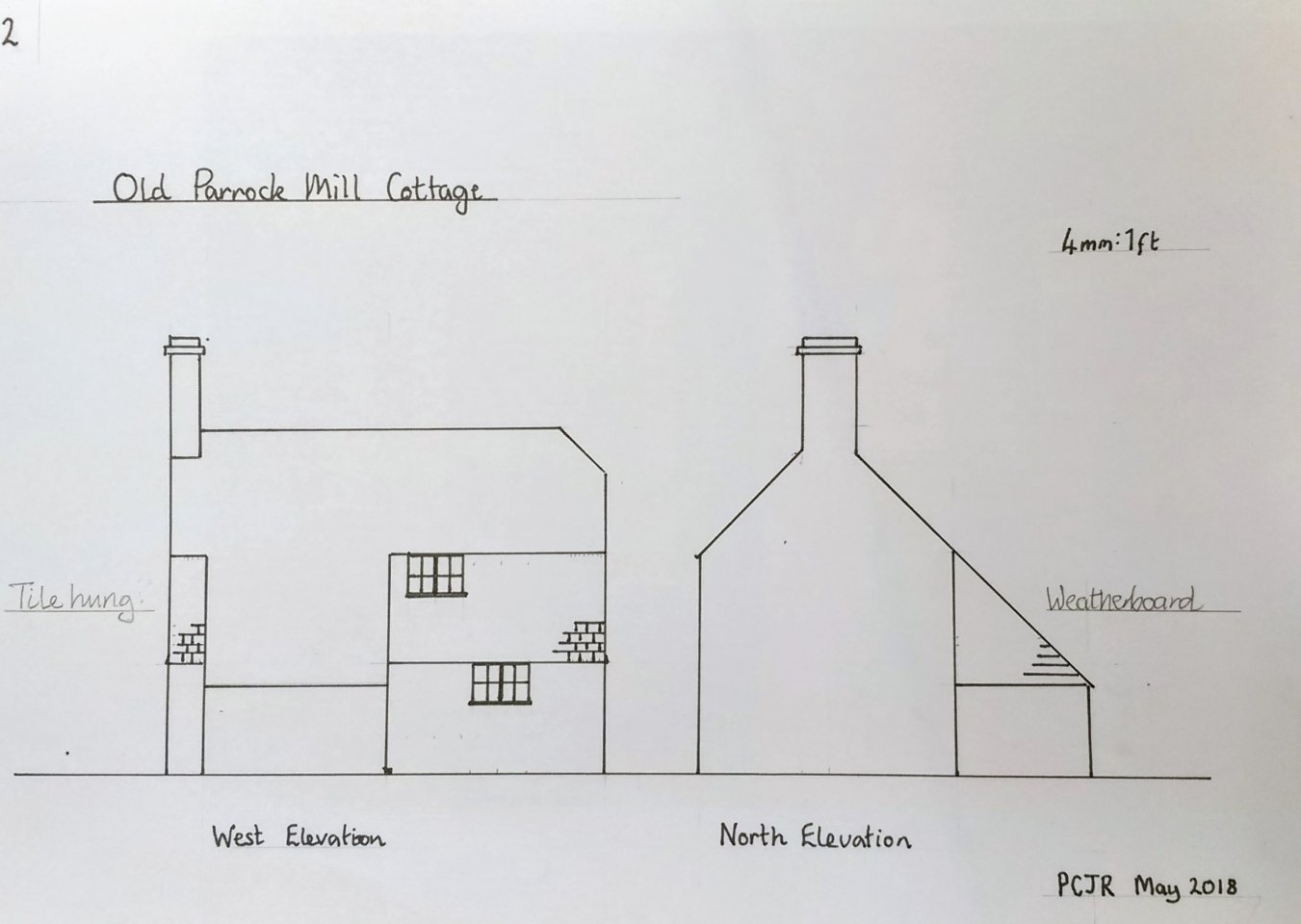

Odd moments during my holiday in Perthshire have been productive, and I now have a set of working drawings for my mill cottage. It's based on two buildings - the mill cottage illustrated above, and a cottage which was lived in by a friend of mine at primary school.
I've sought to avoid a chocolate box look, and used my (fairly amateur) knowledge of Sussex vernacular architecture to create something possible 80 odd years ago. I've actually learned quite a lot along the way.
The south elevation fascinates me. From photographic evidence it is pretty much authentic - an odd mixture of beams, windows and black weatherboarding.
I've had to recreate the rear 'west' elevation as the mill cottage has been extended on the back and no photos have come to light.
I'm looking forward to getting started on building this. By the way, if there's any weirdness in this post it's because I've done it on my phone, and I'm extremely clumsy on it.

Your recreation of the west elevation looks convincing, and that south wall looks very interesting - it should have quite a visual impact. The whole building seems to have a rich mixture of materials and textures. Very nice - I'm looking forward to seeing it.

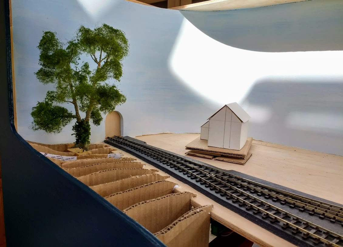

I was heading off to Pendon today but the clutch went on the car. So... I've had a lot of fun making a start on the scenery for the cameo layout.
I'll openly admit that I'm nurdling as I go but I'm quite pleased so far. I've decided that the cottage will need an outside privy.
