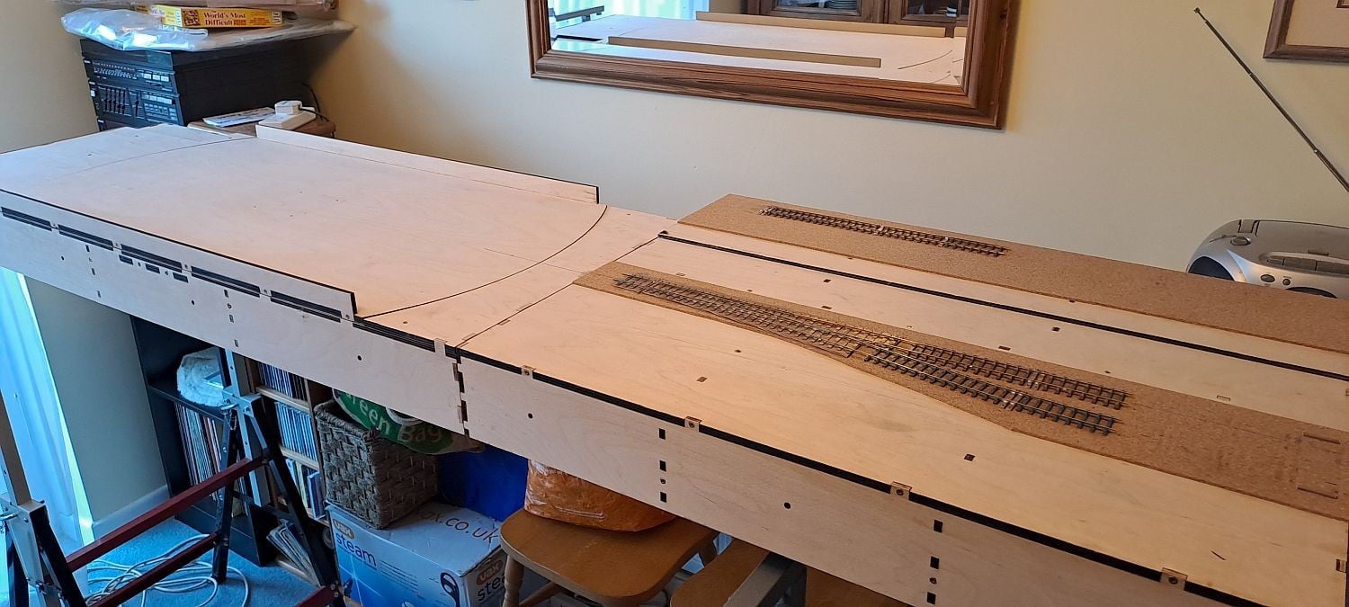

Further work has taken place on the fiddle yard of late, with the focus being now on the main turntable board (both boards made for me by Tim Horn, the turning part of the turntable is three feet in length):
There will be a minimum of three roads on the turntable, more if I can get the geometry to fit. Here is some track loosely laid to give an impression of what it will be like:

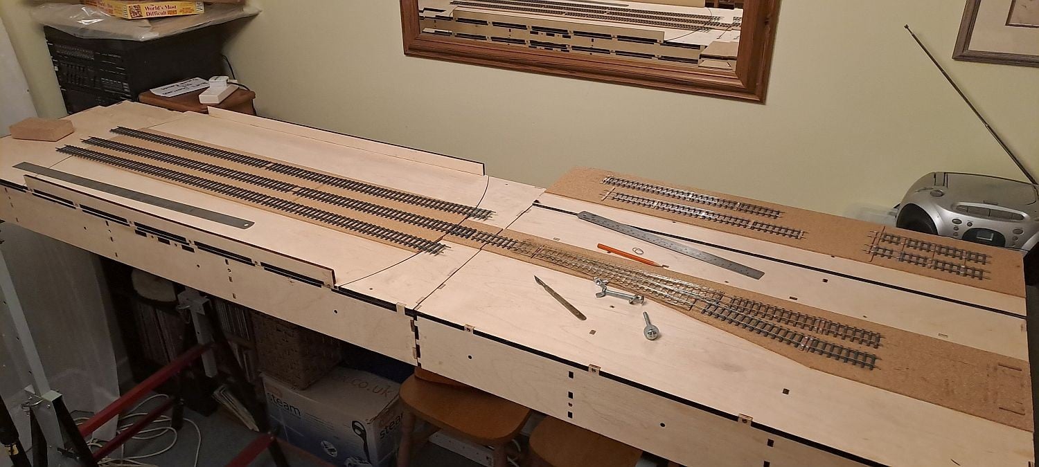

First piece of straight track (centre road) being glued in place:

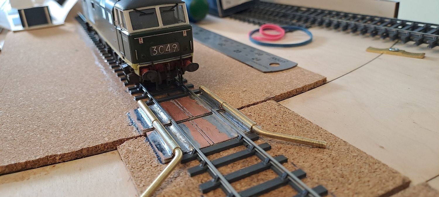

The alignment is based on the two 'turnbuckles' keeping the turntable surface level with that of the adjacent 'dry land' and then two brass bolts in brass tube, soldered onto copper-clad paxolin. The brass bolts are a snug fit in the tubes and also provide electrical continuity:
First powered movement onto the turntable:

Next job is to lay the other two roads on the fiddle yard.
