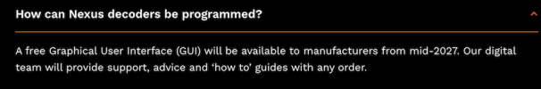

A new development here.
Not sure about home programming options (although compatible with all DCC systems so I guess all of the options discussed in thread above), but a free interface will be available to manufacturers (presumably of the RTR kind) - and you can load your own sounds direct to the chip.

RichardG
Stereo trains eh?
I will admit here, that if I wanted to listen to white noise then I would enroll in one of the those SAS-style character building courses where they lock you in a darkened room and play white noise at you. Though I will admit, some people do buy into this sort of thing. Apart from sound stopping me from thinking or even relaxing, I feel an entire train makes a noise and this is where sound doesn't work for me.
Nevertheless, I have succumbed to DCC after holding it off for five years, and so I suppose I might change my mind. I wonder what a real 'Nellie' would have sounded like.
